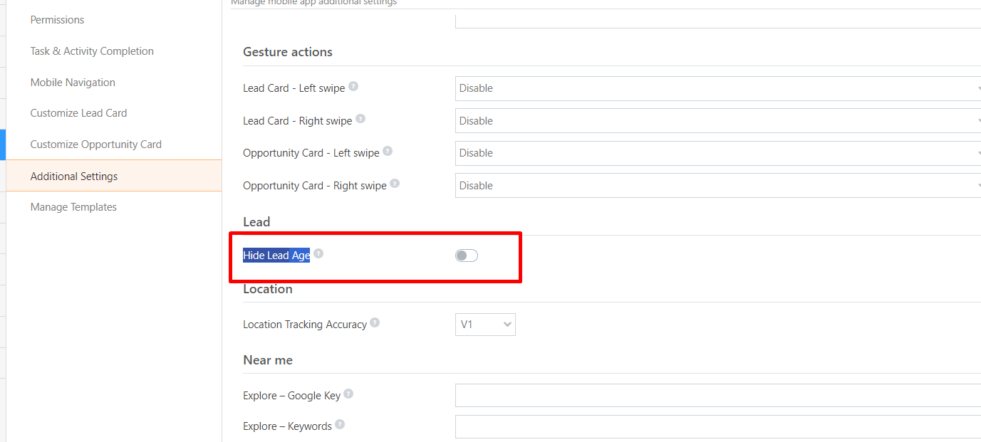

Scenario: How to hide lead age from the Leadsquared mobile application.
Solution:
Steps to hide lead age:
If you see in the Mobile App by default the lead age will be shown up against the leads,
If the customer wants to remove the lead age then It is not possible to do it through Permission Template as in the permission template the lead age field is not visible.
To remove the first lead age form the view route to Mobile App Additional Settings (leadsquared.com) and search for the settings Hide Lead Age and enable the same.

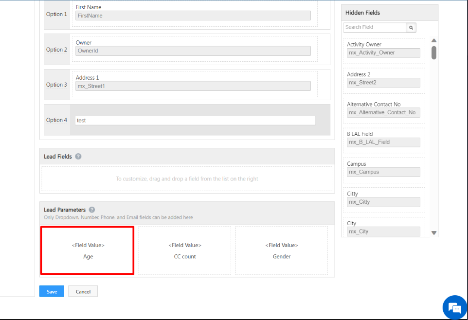

For removing the 2nd lead age field you will need to route to Settings: Manage Forms (leadsquared.com) and remove the lead age from the below mentioned location.
