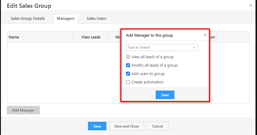

Solution:
Assign the sales users to a sales group and make each of them as the sales manager of that sale group and make sure the below settings have been enabled while making them sales managers,

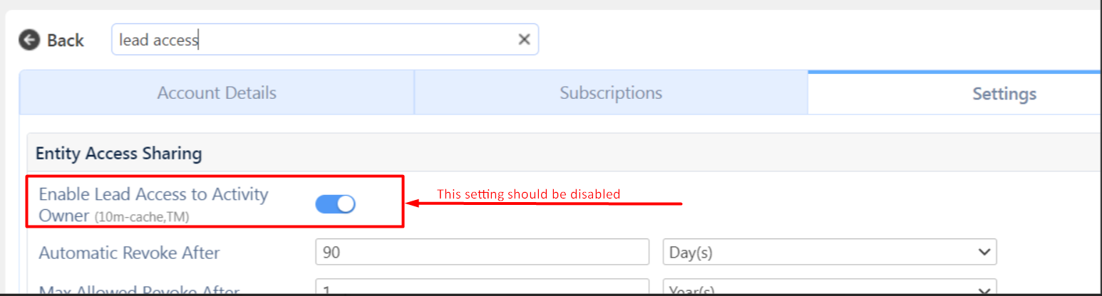

The above may not work if Reporting manager based hierarchy is enabled for the tenant before implementing the same please check if this setting has been disabled for that tenant.
TM Setting Screenshot
