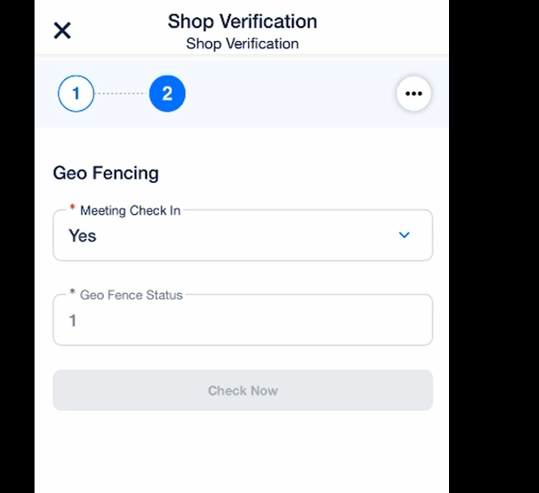

Scenario: The user was performing the meeting check-in activity from an Android device, and it is working as expected. However, when I perform the same activity from an iOS device, it throws an error.
Root cause:
In the regex configuration customer has used " ^(true|0)$ " which is compatible for android but not for the IOS, as it takes " 0 " value as a false.
Solution:
Reconfigured regex using ^(true|1)$.
