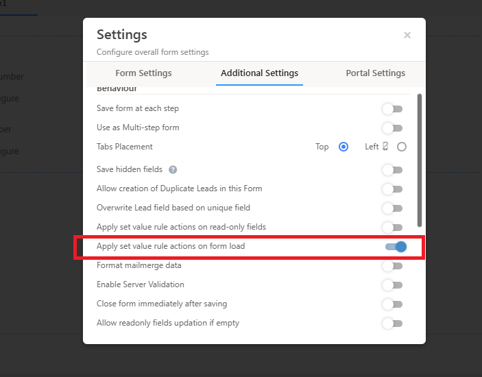

Scenario: User has reported that the form rules (Fetching mavis value from DB) are working as expected in the web platform but in mobile application.
Root cause:
We have two different scenarios:
1. Form configuration setting miss:
  1. The field used in the rule was triggering on load.
  2. The form rules were working as expected in the web platform but in mobile it was not working.
  3. The setting in the rule " Apply set value rule actions on form load " was not enables
2. Platform issue:
  1. If the form rules and settings are correct - then need to be checked with the platform team.
Solution:
1. We have made changes in the form settings.
